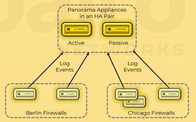

In current setup we have Panorama M200 in HA pair and managing location A and location B firewall centrally. We have enabled local log collector on both Panorama and added in same collector group with redundancy enabled.
Also log forwarding preference is enabled , in which location A firewalls sending logs to Primary-Active Panorama and location B firewalls sending logs to Secondary-Passive Panorama. As redundancy is enabled in LC group , both Panorama storing copy of each other.

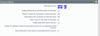

2. Currently we have configured Location A Panorama as primary and location B panorama as secondary in all locations firewall devices. Does this setting is effective only in case of firewall management when Panorama is in HA. Because as we are adding new LC in logger mode in existing LC group of Panorama where built in LC's also added , how firewalls will forward the log to this third LC if we keep this as a primary in log forwarding preference list for some firewall. As we are not mentioning third LC ip in panorama setting of firewalls.

2.) You do not have to modify this setting. On the Firewall side, you configure only Panorama Manager IP address (Primary and Secondary in the case of HA), so you can keep this setting as it is after you bring 3rd log collector online. The Firewall will learn log forwarding preference after it is registered to Panorama Manager.
