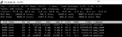

If I run the command "show running resource-monitor second last 60" so I can see that this firewall have 4 cores. 3 out of 4 cores are for DP and only one core is for MP.
Now if I check the dashboard, I can see that firewall MP is constantly high. I ran the command "show system resources follow" and observed that 'userid' process is constantly utilizing 70to 80 % CPU.
I further checked the userid logs and I have observed that firewall is trying to make a connection with Terminal Server Agents configured in the User Identification which is getting failed. There are 7 TSA are configured.
Please advise below:
1. As per my understanding, as firewall is trying to make a connection with TSA agents constantly, this is the reason process 'userid' is showing high and this is the reason MP CPU is also showing high.
2. Also, I am looking for confirmation regarding no of CPUs and cores for this firewall.
