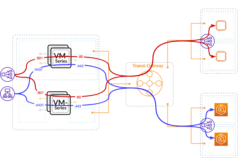

Hi Team,
Does PA have the capability to perform routing based on HTTP headers, which can be leveraged to send the traffic to right ALB.
Thanks in advance!!
Om
We cannot route to the backend via an HTTP header.  We would typically deploy the ALB on the front side of the firewalls and use port address translation to maintain the application mapping through to the backend application.  Here is a sample diagram of what that would look like.  TGW is optional.
