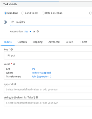

We are working on a WebEx playbook where IPs need to be added to proxy profiles. However, we are encountering an issue where, if a user mentions multiple IPs, the playbook task fails to add those IPs. Could you please suggest changes that need to be made in that task, as well as its input transformers and filters? We need to figure out how to split multiple IP inputs into single inputs. Please find the attachment for snapshots of the playbook errors.
Hi @SOAR-ADMIN ,

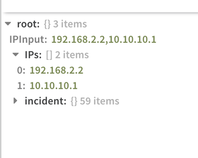

If I understood correctly, you want to get joined elements from the array. For that purpose, you can use join transformer on the array field. Please see the below example.
I hope this answers your question.
