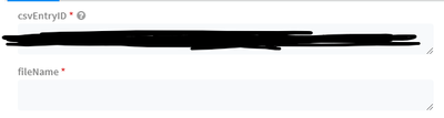

Hi all,
I want to get an argument from user when playbook running. Actually, the first method I can think of is as below. But can you give a more user-friendly example?
Hi @YilmazDincer, The best method is to setup a Data Collection task. The task can be shown in the XSOAR UI or emailed as link (Opens a form if the XSOAR IP is network accessible).
For more information refer - https://docs-cortex.paloaltonetworks.com/r/Cortex-XSOAR/6.11/Cortex-XSOAR-Administrator-Guide/Create...
Other options:
 - Ask Task https://docs-cortex.paloaltonetworks.com/r/Cortex-XSOAR/6.11/Cortex-XSOAR-Administrator-Guide/Create...
 - EmailAskUser https://xsoar.pan.dev/docs/reference/scripts/email-ask-user
 - Email Communication (Allows users to send emails to XSOAR that then get added as comments) https://xsoar.pan.dev/docs/reference/packs/email-communication
