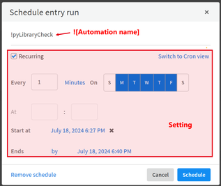

I'm trying to run an automation every hour which checks for Warroom entries and executes certain code in the automation. This automation should only run and check on the active tickets. The automation itself works, but I still need to execute it with a command in the Warroom at the moment. I've created a job that runs every hour, but I can't seem to link the automation script to it.
Can someone explain to me how I can execute an automation every hour within XSOAR?

What about running the command ScheduleCommand within WarRoom?
I have tried that and I am able to run Automation periodically within Warroom.
(I have Automation running every minute to see how it works, and so far it has been successful.)
