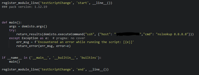

- below are the images that show the behavior of the script:
Inside the script I executed this command:

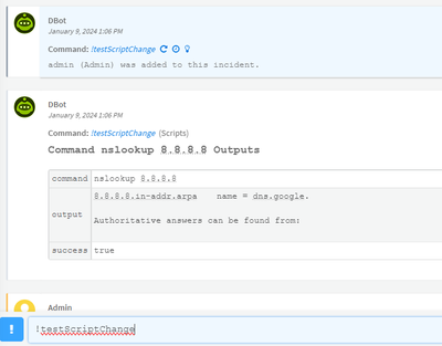

and if I run this command from the command line it works fine:

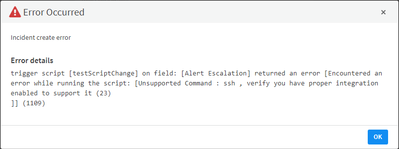

but if I run it in relation to the modification of a field it gives me the following error:
