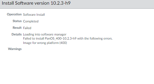

10.2.3 Software Update Install Error
The firmware is not being updated.
The question is the application version.
Is there any way to solve the problem?
the error message states its for the wrong platform
are you uploading the package manually? (in which case you downloaded the wrong image, go download the file for the correct platform)
if you're trying to do this via the GUI, click the 'check now' button first to refresh the repository before downloading again
