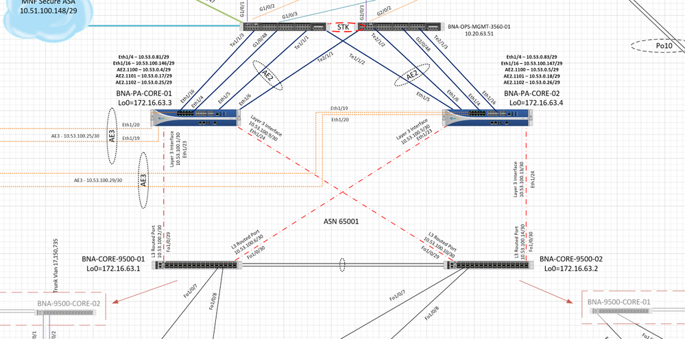

HSRP is only lan side for servers and clients. Layer 3 routed ports from each 9500 to each palo, iBGP full mesh.
Ya Doesn't apply here since I am fully meshed not using route reflectors. This is because route reflectors will only insert the one BGP route in the route table as a method of loop prevention. Its a real killer actaully.
