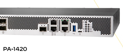

Hey,
I was wondering if the PA-1420 model had physical alarm contacts or done through ethernet.
Also by looking at the front panel in the datasheet only, I see a USB-C? Can I surmise that this is where the power supply can connect to the firewall?
Hi @emily.nicholson ,
The PA-1420 does not have any physical alarm or dry-contact interfaces; all alarms and status notifications are delivered over the network using the configurable alerts like SNMP, syslog, email alerts, Panorama, etc.
Also, the port on the front panel that appears to be USB-C in the diagram is actually a micro-USB console port. The firewall itself is powered exclusively through the rear AC/DC power inputs.

@emily.nicholson  You only see alarms under the Monitor and Alarms tab.
Also, you see some issues under the Monitor and system logs.

Noyou cannot assume that the USB-C (if present visually on the front) is the power supply connector. Usually, a USB port on the front is more likely for console access or diagnostic/maintenance functions, not the main AC power input.
The PA-1420 doesn’t have physical alarm or dry-contact inputs, all alarms are handled over the network using SNMP, syslog, email or Panorama. The front USB-style port is just a micro-USB console port, the firewall is powered only through the rear AC/DC inputs.
