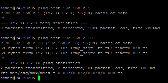

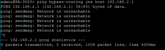

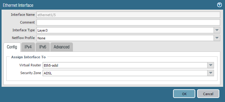

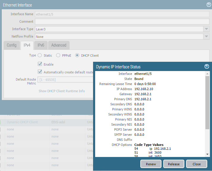

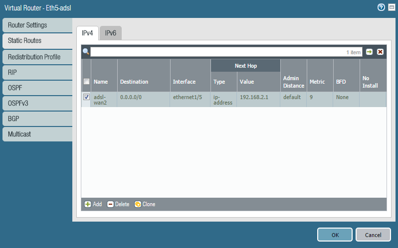

i've connected a adsl modem to our 3020 to redirect some clients to,  configured the interface as dhcp client, the port successfully gets an ip address from the modem but i can not ping the modem interface from firewall's cli. I might be missing a simple step but i'm fairly new with PA, any help appreciated, thank you

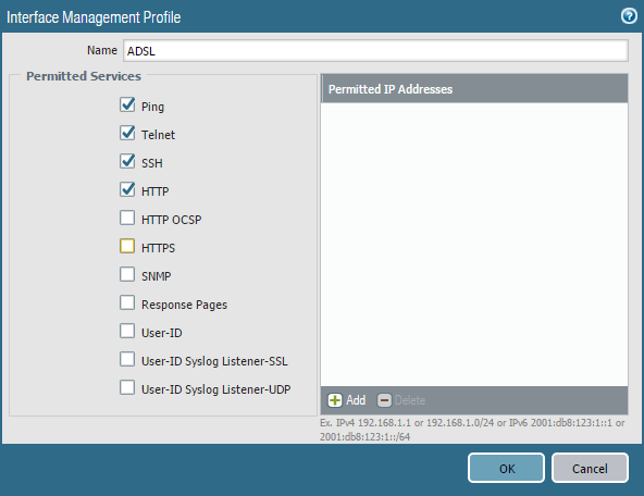

Hi Oseberg,
Welcome to the community forums!
Create an interface management profile, tick the 'Ping' box and add it to the interface eth 1/5.
Hopefully that should take care of it.
Anurag
ACE 7.0, 8.0, PCNSE 7
Sorry for not mentioning but i've already created a management profile with ping, ssh, telnet and http, and attached it to eth5
MGMT profiles will work but only for traffic directed to the Palo interface. If you are initiating the traffic from the Palo ping should work (so no MGMT profiles required). ADSL modem simply might not reply for pings. Are you able to access the internet over that link? You can test with this command:

i cannot ping from source 192.168.2.1 i get an "bind: cannot assign requested address" error
But i can ping google dns from source 192.168.2.10
So is it working as it should ?
Sorry l had a typo. You need to source from your assigned ip address by ADSL modem 192.168.2.10
First off: please don't attach this profile to your WAN interface, especially telnet and http are bad ideas to expose to the internet (they expose your management interface to the whole wide internet, unless you set strict security profiles)
I'd recommend setting up GlobalProtect for management tasks
