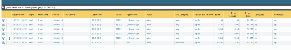

image.pngimage.pngHi,
When we detect that a communications channel is saturated because someone or something is downloading a large file or occupying the entire bandwidth.
We do not know how to see in real time in the web interface of a PA-500 (firmware 7.1.6) that is happening.
It is only possible to see it once the communication has ended. That is, if I download a 100gb file. Until the file is downloaded
I tried it in  it in the "Monitor / Traffic" tab or in the ACC / Network Activity / Last 15 minutes tab.
I know that exporting the traffic through netflow to a program that analyzes this type of traffic is possible to see it.
Is there any way to see it in Palo Alto, even if it is by the command line?
Our intention is to know who or what protocol is occupying the traffic at the time of detecting it.

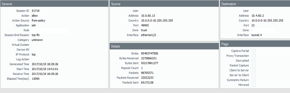

ACC data is delayed by a bit. Its data comes from session logs, which only get recorded after the session has ended.
You can check the active sessions though, which will give you an idea of what's going on. It's available in the CLI and under Monitor > Session Browser. You won't be able to see only sessions over say 50GB, because the largest minimum size you can specify is 1GB.
In the Session Browser on the GUI, use this to see active sessions larger than 1 GB:
(min-kb eq '1000000')
Similarly, in the CLI, you can use:
show session all filter min-kb 1000000

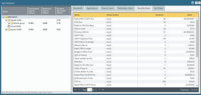

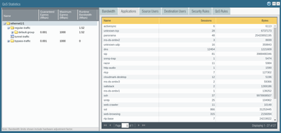

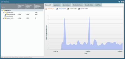

You can also enable QoS on a physical interface (you don't need to actually use it for anything, just enable it).  This will then activate a Statistics link on the Network --> QoS page for that interface.  If you click that link, you get a real-time view of the network traffic passing through that physical interface.  And there are sub-tabs in that dialog that shows the Applications, Source/Destination Users, Security Policies, and QoS Policies that are generating the traffic.  The data displayed is for the last 60 seconds worth of traffic, I believe.qos-dialog-1.png
