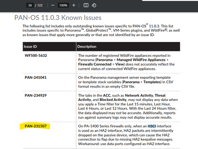

Looking at the release notes this might be pretty close to what you're seeing:

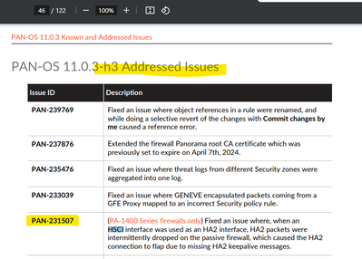

Also looks like 11.0.3h3 fixes the HSCI problem:
You can see my recent post it looks like there's a published bug specifically for the 1400 series.  So at face value it shouldn't effect the 3400, but anytime a vendor says it "only effects "X" hardware type" I get a little suspicious that maybe other hardware version could still be impacted.
Maybe try running the 11.0.3h3 code and see if that fixes the issue?
Thanks brandon. We have upgraded to the said version but no luck. Raised the RMA for the cable. I will test once it arrives.
