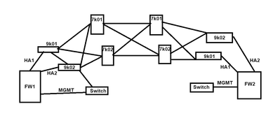

@IT-Esp  We have few PA across the DC running in Active Passive Mode.
We have Two Switches in Each DC running VRRP.
HA1 and HA1B has connection to local switch in each DC.
HA2 we have Single Mode connection directly between the firewalls.
HA2 backup also has connection to Local switch.
We have no issues with this design.
