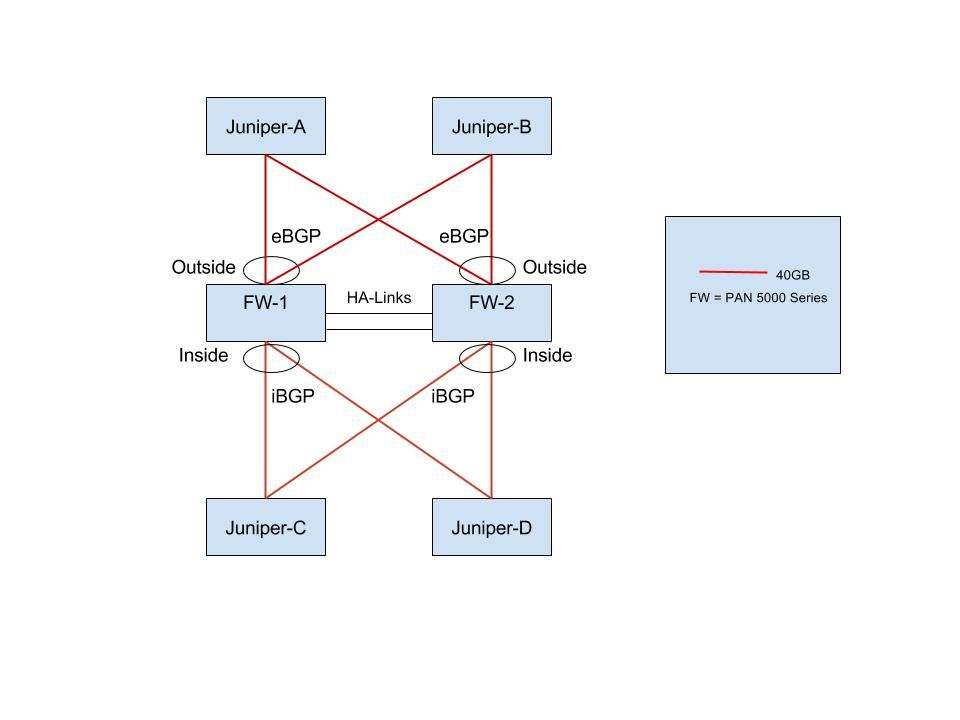

I am working on the following HA design -
As you can see above, each firewall will have two interfaces connected to Juniper routers on the inside and outside zones. The firewall peers will also be directly connected to each other for the HA links.
The plan is to use Active/Passive deployment and I am trying to figure out if this design can be achieved without any Layer 2 switches.  The main question I have is around exchange of hello messages and link monitoring. How do the firewall peers exchnage these messages if there is no L2 switch in the topolocy? Is that done over HA links?
Would this design not work due to the missing L2 switch?
All exchanges of information between HA members if via the HA links.
The tests are run on the firewall connected to the link under test.
Link monitoring and path monitoring are about watching the connection status between the PA and the connected device.  This is not about monitoring the status of the HA pair. This does not matter what the connected device is.
So when you configure link monitoring you are watching for the link status between the PA and the other device going link down.
Path monitoring is using the selected link to run the ping test and can detect failures upstream of the actual link failure.  The link can be link up but not able to reach the internet for example because of failures beyond the link itself.  But this is testing the path to the rest of the network or upstream and not the HA status of the two devices.
Thans Steve. But how is the PAN firewa exchanging the link status information? Are they running any tests across those interfaces or do they simply exchange the link up/down status over the HA links?
