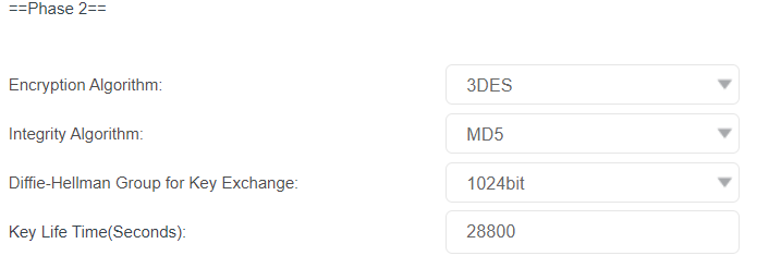

I have several TpLink Archer Mr400 4G Router. I setup Ipsec VPN tunnel between PA-220 and them many times. But new one is not success at Phase2.
Phase1 IKE is green so devices communicate. But Phase2 Tunnel Info is red and i can't see any tunnel when i click Tunnel Info. I have read the losg and find below things;

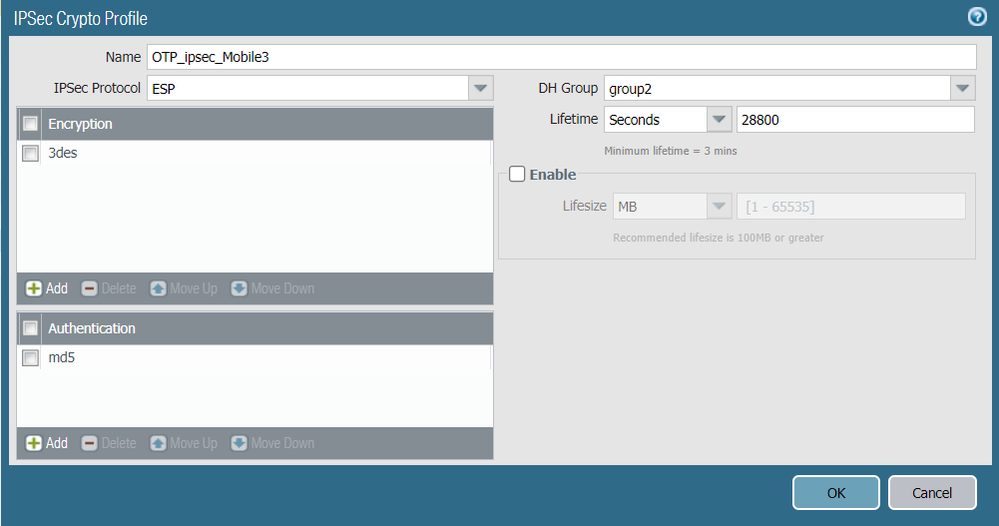

I double check both side PA220 and Tplink phase2 configuration and everyting is same.
TPlink Archer MR400 Phase2 Profile;
PA220 IpSec Crypto Profile;

Problem resolved.
TPLink router side "Ip Address of VPN" should be 192.168.1.0/24 instead 192.168.1.1/24
