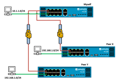

Say I have site-to-site IPsec tunnels from my Palo to 2 different peers.  How do I handle the case when the 2 peers have the same or overlapping networks?  Do I ask one of the peers if they can NAT their network to something that doesn't conflict with my other peer?  What if neither peer is able to NAT?
Hi @RaymondLeeDOT ,
It would be easiest for you if one of the peers can handle NAT on their end and use a subnet that works for your environment. If none of the peers can handle NAT, you'll have to create 2 separate subnets for each peer and take care of the NAT for their connections.

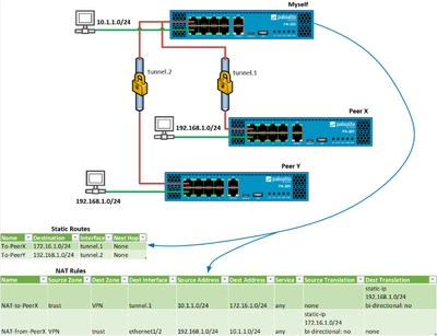

Hi @JayGolf,
If I were to do the NATing on my end, can you explain why I would need 2 separate subnets?  I would just need to NAT for one of the peers in order to resolve the IP overlap, right?  Assuming that I'm NATing 192.168.1.0/24 to 172.16.1.0/24 for Peer X, do my static routes and NAT rules below look correct?
However, if I need to create more tunnels to other peers who also use 192.168.1.0/24 on their side, then it's going to be a NATing nightmare for me.
