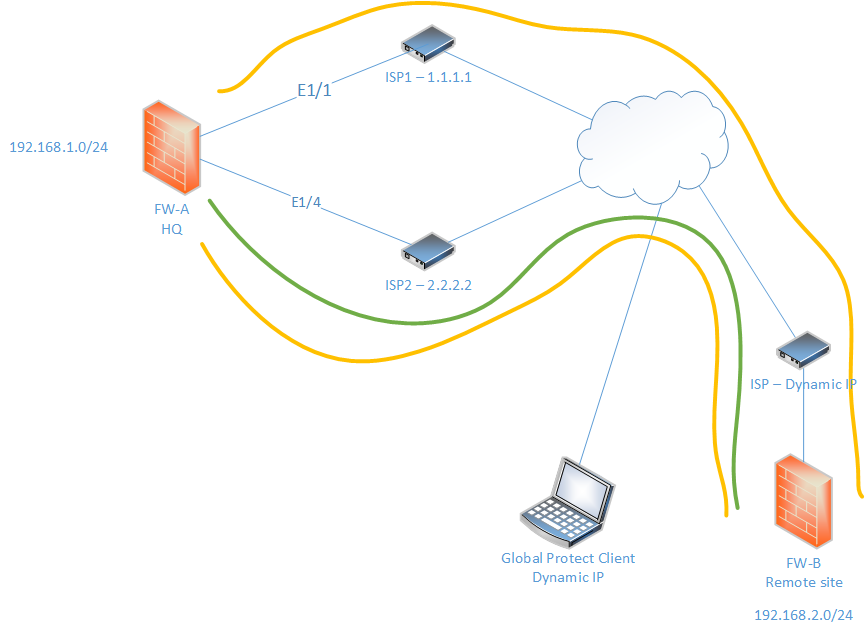

I enclosed a drawing to make it more clear.
On IKE GW local interface is configured to e1/4 - so all IKE1 traffic goes well (green line).
Unfortunately ESP packets are load balanced and goes via e1/1 and e1/4 (orange lines).
What I have to do is to force PA to send ESP packets via e1/4 interface.
ESP packets always have correct IP source address (2.2.2.2) only issue is that half of it goes via e1/1 interface.
Thank you in advance for your help.
Przemek
