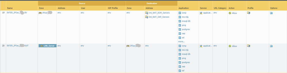

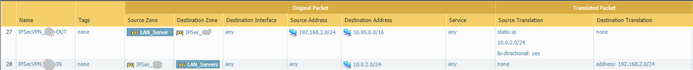

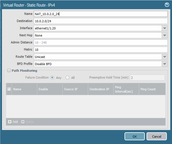

Below is the configuration that finally worked.
Static Route
NAT
Security rules

The NAT rule shoild look like this
  • Original source: 192.168.2.0/24
  • Original destination: 10.95.0.0/16
  • Type: Static IP
  • Translated source: 10.0.2.0/24
  • Translated destination: none
And what about the other way?
Traffic from the oher side that wants to arrive to servers in our network - 192.168.2.0/24?
Check the bi-directional checkbox
So, it's this, right?
IPSecVPN_xxx-1
to [ IPSec_xxx ]; from [ LAN_Servers ]; source [ 192.168.2.0/24 ]; destination [ 10.95.0.0/16 ]; source-translation
static-ip
bi-directional yes; translated-address 10.0.2.0/24;
Yes, looks correct.

In vRouter I have a static route for 10.95.0.0/16 directing it to the tunnel.
Should I have anything more there?
