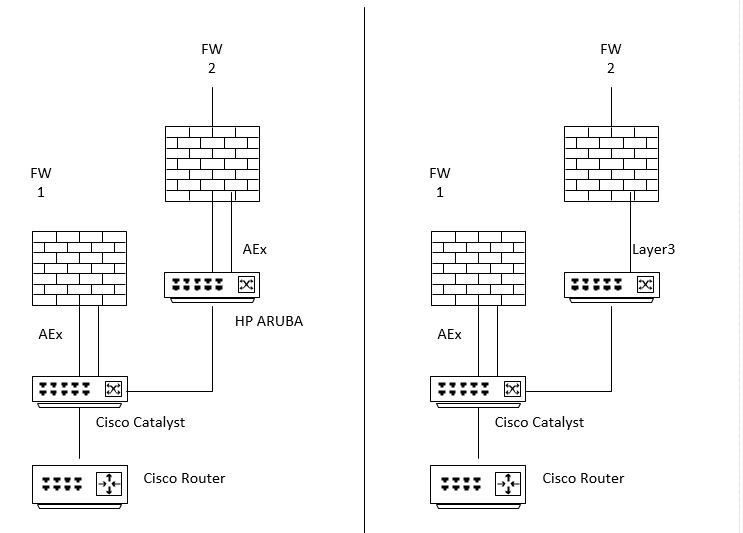

I have a strange issue.
I am setting up a new 850 HA pair A/P
To the outside world is a LACP Aggregate, connected to a HP switch.
All was going well when testing, I can ping a dummy device (laptop) fine on the outside switch from the firewall.
But when I connect to the firewall to the upstream router, pings to google all get ( DUP ).
If I connect the laptop to the upstream, pings are normal.
Our other old PA3020 cluster is fine?
9 REPLIES 9
So, in the diagram below.
LEFT SIDE
FW2 is connected on a Aggreagate to a HP Aruba, the Aruba has a standard LACP enabled trunk.
The aruba connects on to a Cisco Catalyst, and then onto the ISP router....
In this configuration, every packed seems to be reported as duplciate on the CLI.
If I remove one link the issue persists.
RIGHT SIDE
FW2 is connected on a single L3 to a HP Aruba.
In this configuration, every packed seems normal.
Conclusion
None so far, I am thinking it may be cosmetic.

2. We've had many issues with HP equipment, LACP and STP.  I'd look into firmware upgrades to see if this fixes your issue.  You could also try forcing the aggregate and disabling LACP (even though I wouldn't recommend this unless you are desperate).

Have you tried removing the Aruba from the equation and going straight to the Cisco?  Is the Aruba even necessary?

Cisco C9200's turned up yesterday, got them stacked together and configured.
Moved the Palos from there test location to the rack with the cisco's..
Connected everything up in the expected way.
Ping to google..
17.1ms
17.1ms
etc..
Not a single DUPE super solid.
So thaks HP/ARUBA, another great product you have there..
Rob
