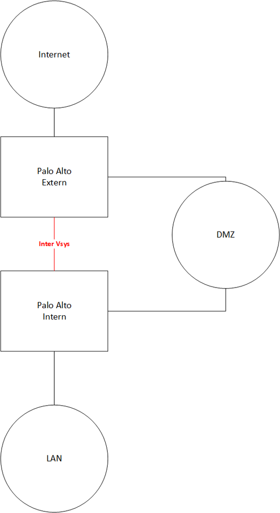

All internet traffic from the LAN uses the inter-vsys connection (red) for internet. Best way to tackle this would be to consolidate the two vsys to one but that would be a large operation.

How is the inter-vsys connection currently setup?    and the proposal fix look like?
Current: Direct inter vsys routing between two vsys on same physical device.
New: Using 4 interfaces (2 per vsys) and aggregate them to form a 2 Gbit link (UTP). SFP 10 Gbit interfaces are all in use. Traffic won't exceed 2 Gbit. Make it a L3 connection.
So, direct cables from one interface to another between two vsys on same physical device.
