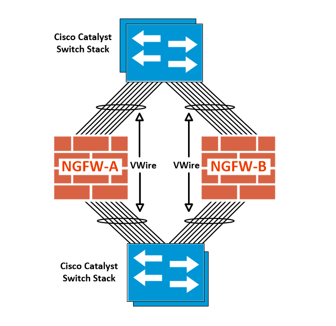

Have pair of 5220s in Active/Passive HA. I'm reading that multiple zones cannot be used on VWire, well actually i'm finding that documentation not so clear and it could be functionality added in later releases of code.
Anyway let me try to explain. I wish to bond (AE) eight + eight 10Gig interfaces to forming  a single 80Gig VWire. Each end of the VWire will physically attach to Cisco switch capeable of LACP if needed.
Once the single VWire is set-up, can multiple Subinterfaces and Zones be configured and allocated across different vSys's?

hi @nawaza
yes, you can create (vwire) subinterfaces and then you will be able to configure unique zone pairs for each subinterface
