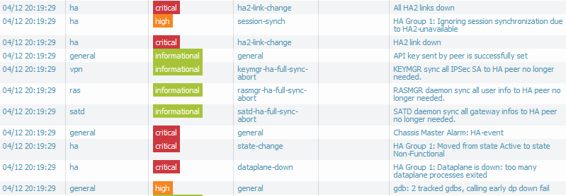

My PA-850 Active/Passive cluster went non-functional last night causing an outage at our main corporate headquarters.  I do have a ticket in with PA but they're being a bit slow to do a root cause on this so figured I'd post and see if anyone has ran into this before.  Just before the cluster went non functional the logs looked like this for the active node:

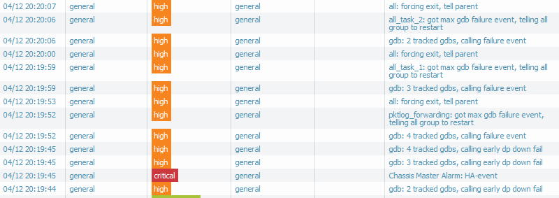

And the passive node looked like this:
