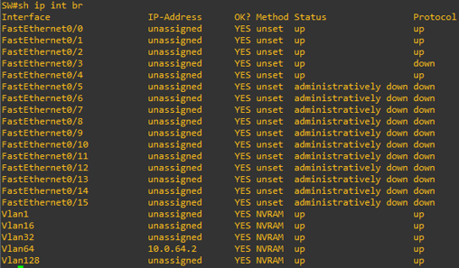

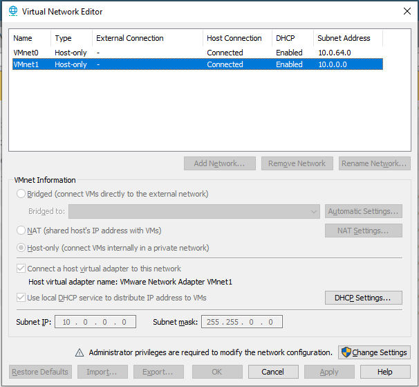

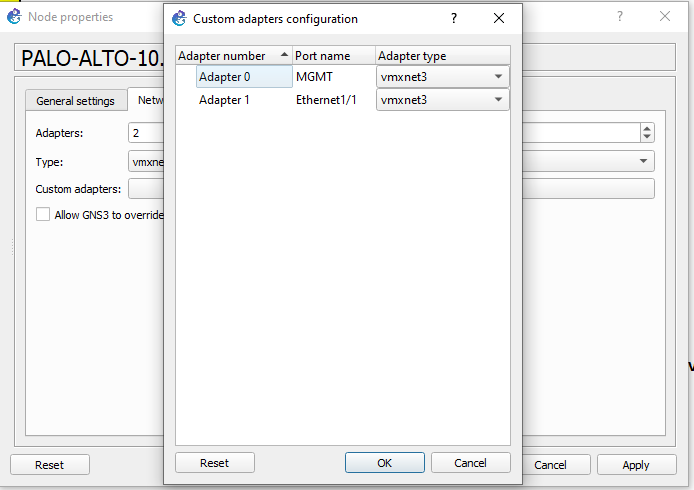

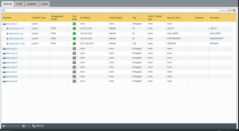

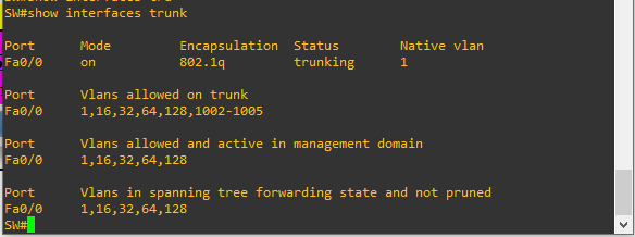

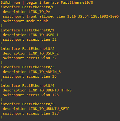

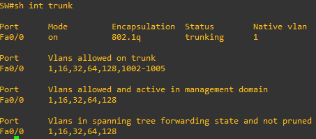

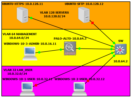

I've configured up two interfaces on my PA-VM (management 10.0.64.3 with VMnet0 - 10.0.64.0/24 and data with VMnet1 - 10.0.0.0/16). Management is directly connected to PC with Windows and Ethernet 1/1 to FastEthernet0/0 on my switch. I've configured trunk on FastEthernet 0/0 and i've problem with interzone routing. Any solutions?1.PNG2.PNG3.PNG4.PNG5.PNG

You ned to change the adapter type of VMNet1 to "Bridged". With "Host-only" this - as the name implies - only a local/internal network on the VMWare host.
You sure that i must change type of adapter to bridged? In this situation i must create next vmnet host-only adapters for workstations? Configuration of switch is correct?
In this lab Palo Alto would be a router without access to Internet. This is only LAN segmentation on vlans (16 - LAN_IT, 32 - LAN_USERS, 64 - MANAGEMENT, 128 SERVERS). I can't ping host or gateway in other zone
Sorry, I missed the third screenshot in your initial post that you have everything virtually on your computer. In this case of course host-only is correct.
