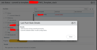

We are trying to push configuration from Panorama HW to AWS Firewall but getting below error
upon following the devsrv we see below:
I am wondering what is "Unable to execute eproxy script. Error (512) " and how to go on resolving as it is not throwing any specific error msg to relate to an issue.

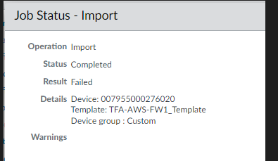

@reaper  yes thats done do.  Along with Force commit too.  The issue is when i add the fw to the pano unchecking the import device config… it throws me an error with warning which is blank. But when i check the import the commit fails with eproxy error. This is very weird.
PrasKtmBoy
while unchecking the import option and following the configd log i can see below. But the interesting thing is i m not using any master key.
The panorama managing this fw was in AWS and now i am trying to bring this to a Hw Panorama.
2023-09-22 12:15:55.816 +1000 Error: pan_cfg_create_imported_nodes(pan_cfg_config_import_handler.c:3145): Could not decrypt firewall config with given masterkey during import of device-group shared config
2023-09-22 12:15:55.816 +1000 Error: pan_cfg_process_device_config_import(pan_job_mgr.c:13499): failed to process device config import request
2023-09-22 12:15:55.816 +1000 Error: pan_jobmgr_process_job(pan_job_mgr.c:4530): device configuration import job has failed
2023-09-22 12:15:56.921 +1000 Error: _pan_schema_verify_node(pan_schema_obj.c:7600): is unexpected , node: cluster near line 1
2023-09-22 12:15:57.057 +1000 client authd reported op command FAILED
