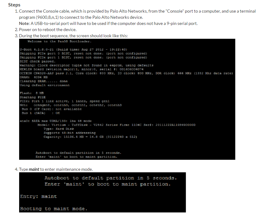

Type "maint" while the device is booting:

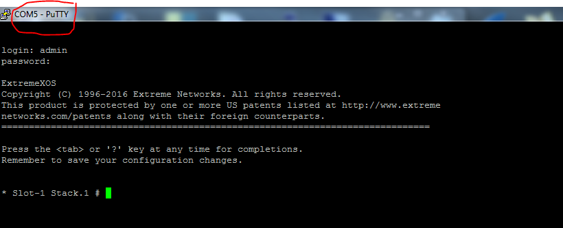

This is what you have to do:
1) Connect your PC to the CONSOLE port on the PA (l am using USB to serial adapter)
2) Open Windows CMD and type mode then enter:
3) Open PuTTY, change to the serial and YOUR console number in the session as per picture. You now should see console output:
If you don't most likely device is for  "spares or repairs" :0 From where did you buy this device? Are you sure it is working or was working?
if you don't see anything at all, you may need to verify your terminal settings are correct: set the terminal emulator to 9600baud, 8 data bits, 1 stop bit, parity none, VT100.
your bootsequence should look somewhat like this
