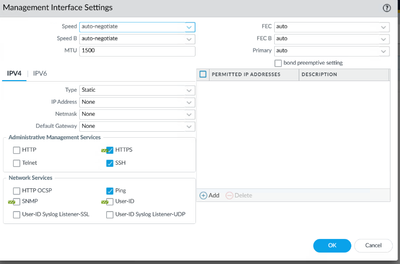

Migrating a firewall and pushed a cloned and modified template to a new Palo alto. Did not push device group. Now I am unable to ssh, ping, https the device.
I am on the device by console. Everything with the management interface looks on and I can ping the management default gateway from the Palo.
What could be causing this?
Sorted it, pushed two templates the main one and a "shared template" their were management acls applied. Added my IP and boom access restored
The management profile pushed in the device template is configured as it should be
