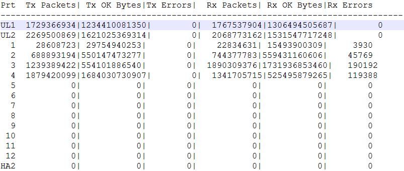

Data receive buffer overrun - is only indication of ingress traffic bursts on the marvell switch port(Firewall DP Ports) .rcv_fifo_overrun errors are suggesting that Marvell(PA's switch backplane) was experiencing buffer shortage/switch port on Marvell fabric is receiving more frames than can be managed and this can be related to bursty traffic pattern.
Errors can only be found on Marvell external ports (phy ports, RJ45) and not between internal
chipsets(From Marvell ---> Dataplane processor). Buffer size cannot be changed/adjusted.
> debug dataplane internal pdt marvell stats
What we are interested in is the UL1 and UL2 (Uplinks to Octeon Processor) and
they appear to be good, in all of them indicating marvell is not sending pause frames or
any recv errors caused by hardware.
 Also the traffic rate in my case and for that particular device was above 20K pps Rcv_fifo_overrun is expected/normal during bursty traffic pattern and it's not an issue on the firewall.
Problem is only when the traffic rate is low and if this counter increases, even with reasonable amount of traffic, then it needs investigation.
