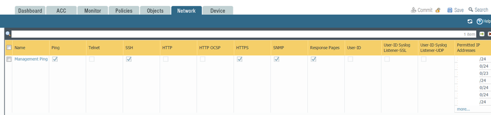

What kind of interface management profile you have on the device.

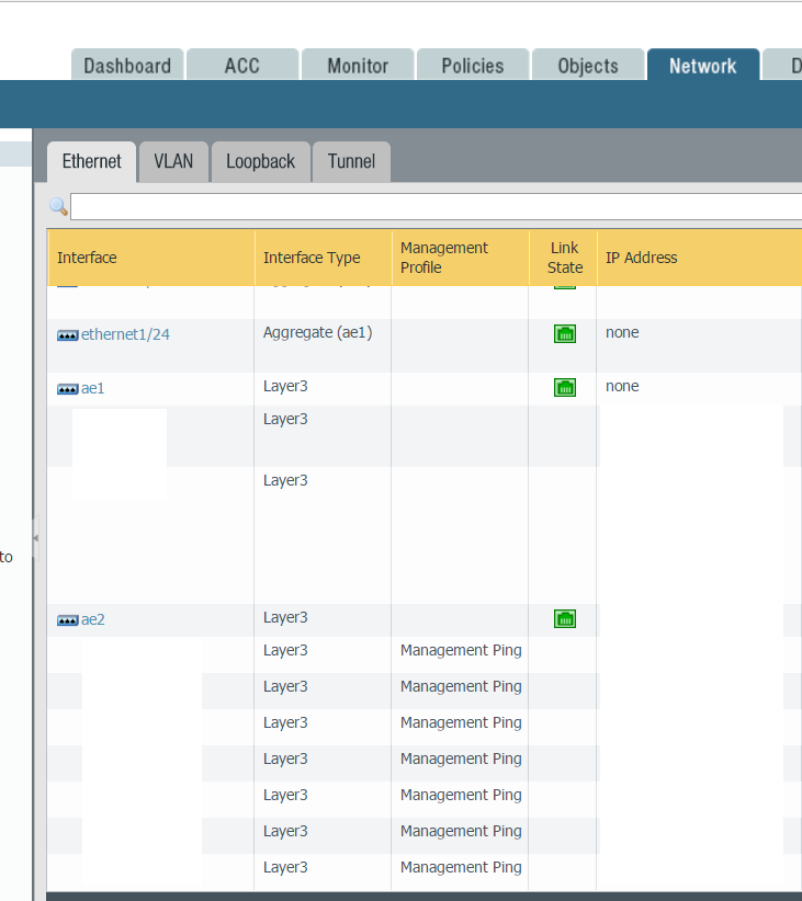

If you allow HTTPS and SSH on your data-interfaces. you should still be able to access it via E1/1,2,3,4.....
I don't think there's a way to get into the appliance via HA, but perhaps you can get into the appliance via a physical interface if you had a management profile, with the appropriate access assigned to it?
Unfortunately, it won't let me in via SSH on any other IPs.  Console it is.  Thanks for the help everyone.
If your HA peer is up and reachable, you could add a management profile to one of the DP interfaces as suggested earlier to the peer device and commit that change. Config sync would go over HA1 or HA1-backup (if configured). Then you can SSH into the DP interface without having to go to the device physically if there's no console server.
