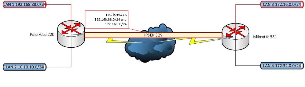

Site 2 site allows only two networks to be pulled inside the tunnel (one of them behind the mikrotik and the other one behind the palo alto).I’ve tried different settings and it doesn't help.
Has anyone had experience building a tunnel between them based on GRE tunnel over IPsec?
Several subnetworks need to be passed through the tunnel.

I have configured s2s between mikrotik and palo alto.
Local networks go between them. I need to add other networks through this tunnel.

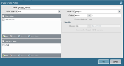

On the Palo Alto, I added another network on the tunnel to the proxy id.

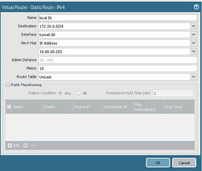

Make sure the policies on the PAN are set to log at session end. On the PAN, are the routes to the 172 networksi n the virtual router and pointed at the Tunnel? Also in order for the PAN interface to respond to pings, it must have a management profile attached to it that allows PING.
Hello/
In the rules, there is a permissive rule from this zone to the lan zone. Then, as a test, I added it to the LAN (LOCAL) zone where all traffic is allowed inside.
Yes, there is a route to the network through the tunnel.
Added MNG profile trust (ping allow) on the tunnel.

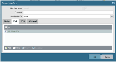

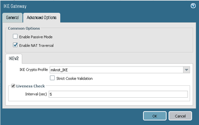

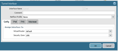

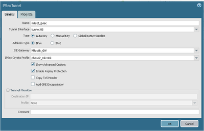

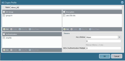

Previously, I set up a tunnel between a cisco router and a PA.
IPsec Site-to-Site VPN Palo Alto <-> Cisco Router w / VTI cc
They used a virtual tunnel interface (VTI) in a cisco router.

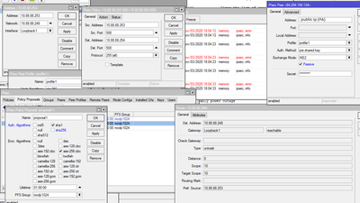

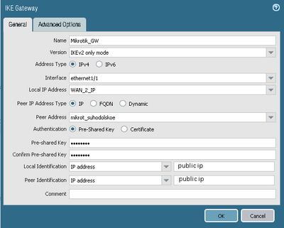

Drawing an analogy, I tried to collect between PAlo alto and Mikrotik.

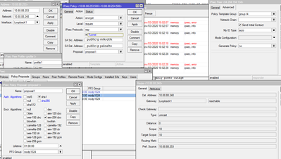

As you know, on microtik you need to separately create a GRE interface, and then apply IPSEC.
I tried creating a loopback on it to hang the address on it.
Then I made the settings for IPSEC, and added a route.
Below I am attaching screenshots of both of the devices with settings.

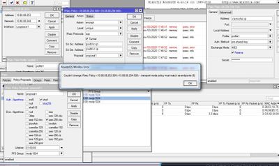

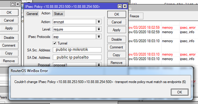

I encountered an error in the IPSEC settings, it does not allow unchecking the Tunnel checkbox.
Instead, it issues an error message "Couldn't change IPSEC Policy - transport mode policy must match sa endpoints".
If you enter the IPSec settings:
Peer Address - 0.0.0.0/0
IPSec Policy- SA Dst. Address 0.0.0.0/0
It does not help.
In 'IPSec/Peer' set only remote peer, not local.
https://wiki.mikrotik.com/wiki/Manual:IP/IPsec
Tried changing policy settings - action , level, protocols. It does not help too.
Anybody have idea?
