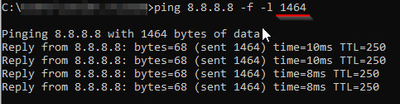

So I went with the suggestion to capture packets (at the PA Firewall transmit stage) and noticed that in Brazil, I have lots of fragmentation happening:
Now, I will try to reach the ISP but it seems from the Cisco router suggested configuration that the MTU is 1492. I confirmed that by using ping packets of 1464 (+28 of overhead) - higher are failing:
Our WAN tech tried to manually set 1500 but the end-result is the same. We will have to talk to the ISP now.
That being said, could this be the reason why decryption is failing? Some odd issues when the PA tries to re-assemble the packets and scan the images? Quite new to PA and decryption, so I definitely don't know that answer - yet.
