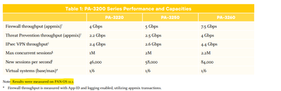

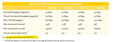

--edit-- shared the hardware specs of the 3200/3400
As an FYI the 3200 hardware platform is being EOLd and replaced with the 3400s.  You can see from the specs the 3400s performance is substantially greater than the older 3200 generation.
