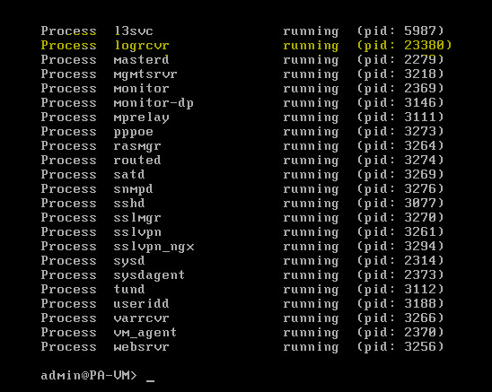

It might be worth checking the logrcvr by running show system software status and if it comes to it maybe even debug software restart process log-receiver to see if that clears things up before you actually restart the device.
Thanks Bryp. I tried re-uploading the key, but everything looks fine from a licensing perspective.
process look fine too, logrcvr is running:
