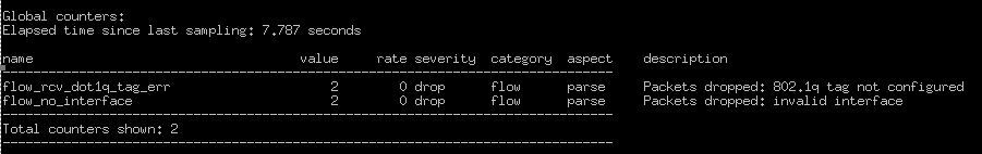

I investigate and found log from Global Counters "Packets dropped: invalid interface".

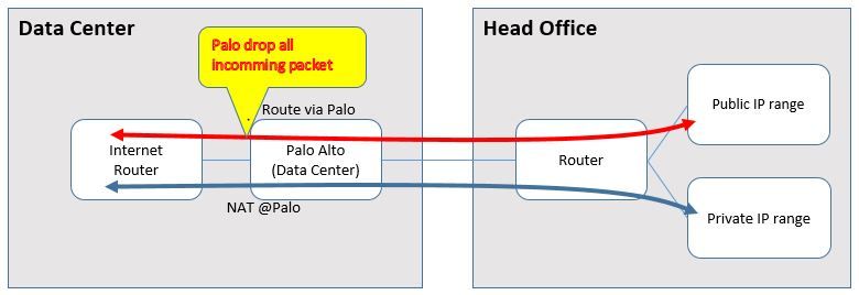

My environment like this. I need to route traffic to my public IP via Palo.

Routing is correct. I can ping from Palo to public IP at HQ. (routing fib is correct)
When ping from internet packet drop by palo as follow counter log.

The invalid interface error could be caused by your VR trying to forward the incoming packet to an interface that's outside the receiving vsys
flow_rcv_dot1q_tag_err usually means you are receiving 802.1q tagged packets on a non-tagged interface (or a tag that is not configured on one of the subinterfaces), you might want to look into that also
Since you have multiple vsys and a path to the main office via both the internet and what looks like an internal link.  I think you are likely dealing with some asymmetrical routing.  Firewalls do not like asymmetrical routing and drop the packet.
To confirm this perform this test:
Run a trace route from the device at the trust interface to the public ip address at the home office in question.
Run a second trace route from the device on the public ip address at the home office back to your trust device (nat address if this is nat or the public address if it is public)
Compare the path on both and verify they go the same way.
