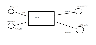

We have a Paloalto connected in vwire mode Cisco ASR1 is  connected on PA eth1/21 (Primary) and Cisco ASA (Primary)is connected on PA eth1/22. Same as Cisco ASR2(secondary) is connected on ethernet1/23 and Cisco ASA(secondary) is connected via Ethernet 1/24. Interface are automatically going down and coming up
Can any one suggest me why is going up and down and more information where is see more information in logs

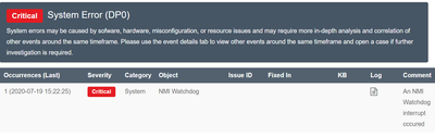

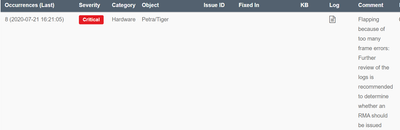

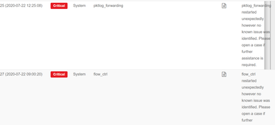

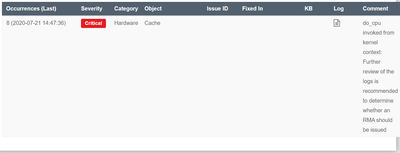

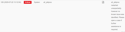

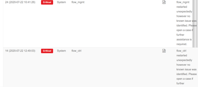

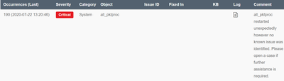

when i check in auto assistant link  iam facing below issue please suggest what i can do now.
Joshan_Lakhani_6-1595682774186.pngJoshan_Lakhani_7-1595682801055.pngJoshan_Lakhani_8-1595682821927.png
Well... have you tried doing what i suggested ?
In regards to autoassistant, did you check the logs further, as it suggests?
if no to both of the above questions, i guess you may want to open a support case and have the firewall checked by support
