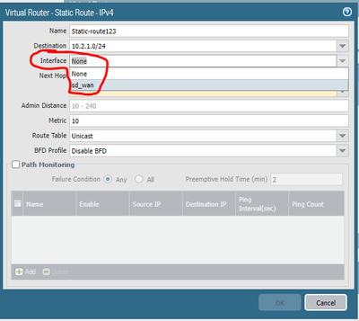

Hi when virtual router - Static route is created, there is not tunnel interface in Interface doopdown option, instead it has only None and sd_wan. PLease see below. why it does not show tunnel interface? the tunnel interface is created. Thanks
Thanks for your question. i have to add interface first under Routing setting.

When you created the tunnel interface, did you add it to the virtual router?
