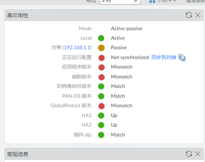

I have 2 PA-440 configure by HA,now one of FW hardware down,And I get a new FW from RMA.now I connect this new FW.
When I press "Sync to peer device", it prompts me that synchronization failed. I understand because I have not imported the license to the new firewall. If I import the license into the new firewall, can I directly synchronize the active firewall configuration to passive firewall?

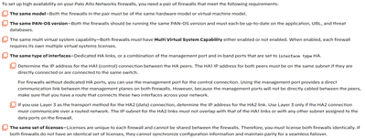

Hello @ZhangShengXiang
this is correct understanding. If both firewalls do not have an identical set of licenses, they cannot synchronize configuration information. Having the same license is one of the pre-requisite: https://docs.paloaltonetworks.com/pan-os/10-2/pan-os-admin/high-availability/set-up-activepassive-ha...
After, you have licensed your passive Firewall, also install corresponding PAN-OS, Threat/App version, then you should not have an issue to sync up.

Got it.You mean it will be syn complete when I import the license in passive firewall.whatever the Passive firewall was empty configuration.
I worried about that because Passive firewall cannot connect to internet,so it cannot download globalprotect version and others,the HA dashboard show globalprotect  mismatch will not impact on synchronization?
Just need these matches in the picture.This is my understand.It's right?

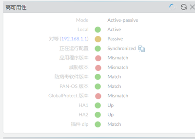

Hi PavelK
I have syn the configuration to passive,but the globalprotect cannot download.should i make this FW to active,and can download version?
Under "Device > Setup > Services > Service Route Configuration" do you use management interface or some dataplane interface to communicate with Palo Alto Networks?
If management interface then both firewalls can pull updates and GlobalProtect software if dataplane interface then only active firewall can update.
