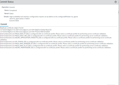

Hi all,
I am seeing the below errors after deploying templates to Palo's when attempting to commit HA configuration.
I have applied the HA IP so unsure why that is stating ip-address to be configured?
Also what is best way to resolve these dynamic list no cert with profile errors?

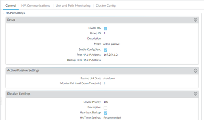

Just seen the older Palo which I am attempting to rebuild is using Aux for HA.. I am unable to create aux ports within device > interfaces...
below is the old firewall
below is the new firewall
How do I create the required aux interfaces? Does hardware need to be in the firewall before they show?
Hello @M.Allen
First you are looking in two different places. The first image with AUX's interfaces it's from Panorama (Template > Device > Setup > Interfaces) and the second image without AUX it's from firewall GUI (Device > Setup > Interfaces).
The AUX's interfaces are used only when you are configuring a PA-5200 series firewall from Panorama.
