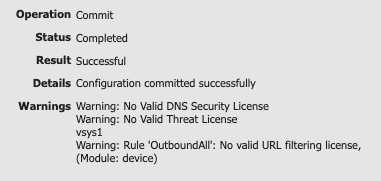

Whenever I attempt to commit changes with subscription based functionality (i..e URL filtering) enabled I get 'No Valid License' errors.

However, when I check the license page I get the following output which leads me to believe the License is valid? and there is no option to fetch the license again.

Hi all, can you please check the instance type. This was caused by chosing the wrong instance type. Vm-series PAYG model in AWS is a VM-300 model, if you do not allocate the right memory and number of CPUs, then, it wont be able to register itself to the license server. I have changed my instance type to m4.xlarge, the everything is working as expected. I can see the instance now is licensed properly (see the below screenshot).  To find out the minimum requirements for VM-300, go to the following link https://knowledgebase.paloaltonetworks.com/KCSArticleDetail?id=kA10g000000ClDCCA0

@jperry1 there is no option to fetch a license in PAYG model. Once you have registrered the CPUID and serial number in customer support portal (https://docs.paloaltonetworks.com/vm-series/9-0/vm-series-deployment/license-the-vm-series-firewall/...), the instance (if properly sized) will download the license automatically.
