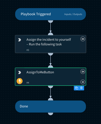

@MKececioglu correct, the AssignToMeButton script does need to be executed manually, either as a button or in the playbook, so that it knows which user to assign the incident to. You could do something like this to try to structure it so the user understands what they need to do:

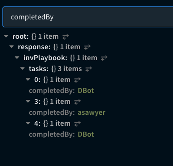

Or as @jfernandes1 suggested above, you can also have the user complete a manual task, then use the API to get that user's username, and assign the incident to them. The following API call returns the Work Plan details (replace INCIDENT_ID with the actual ID):
!demisto-api-get uri="/investigation/INCIDENT_ID/workplan"
Then you can parse the response to find the user who completed the manual task. This key of the response contains the list of Work Plan tasks: response.invPlaybook.tasks
Then you can parse through those (you can use a tag to uniquely identify a particular task if needed), and find the user who completed the task in the completedBy key.

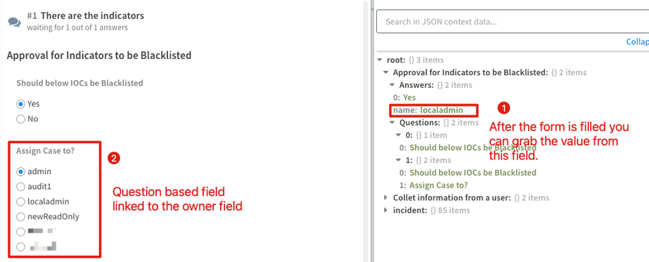

Not sure if this is possible with a conditional task. But it possible with a data collection task. Since it saves the user who fill\completed the form. You can also shorten the playbook task by adding a question based on the owner field.
@jfernandes1 thanks for response i realize that when i set owner field as a data collention question , it automatically populate analyst list and based on the answer, set it as owner which is a great way 🙂 . But still curious about a mandatory "assing to me" selection to deploy.

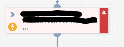

This is really o solution thank you, but i need fix one more thing that this automation keeps error state until someone click "Run automation now" and this seems liken en error to analyst at first sight,  any idea about how can i integrate this into a conditional task or clear the error state befor click.

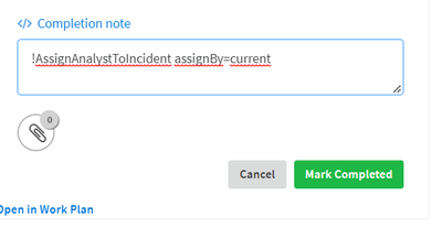

one more thing i realized that xsoar allows us to run commands in "Completion Note" inside a standart conditional match and if i can set a fixed command that includes "!AssignAnalystToIncident assignBy=current"  this will work too.
