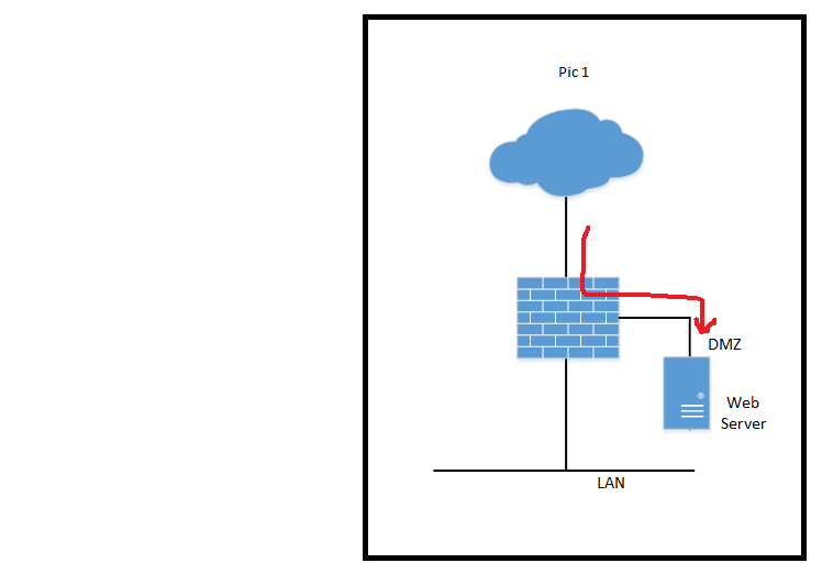

@simsim
The red line in the following pics shows the flow of data requests.
Pic 1. this is for web server access from the internet. traffic is only allowed to the web server in DMZ.
Pic 2. if you use RDP gateways, reverse proxies etc then with a single firewall the data flow from the internet passes into the DMZ and back out again to the LAN via the same interface.
Pic 3. to reduce this in and out (tromboning) effect you can add a second firewall. so.. the data request enters  firewall "1" but the proxied or forwarded traffic passes through firewall "2".
please note... this is only a requirement if you need the extra security or have massive data requests.

thats almost impossible to answer as all network designs, security levels and ammounts of data requests are different.
for simplicity and cost Pic 1 is the obvious choice.
both designs perform exactly the same task of creating a DMZ.
it all depends on the network design, ammounts of data requests etc..
i could not even suggest a level requirement as you could have 2 servers offering mega data or 100 servers not doing much at all....
nowadays data links and firewall processers are exceptional compared to previous decades so it all depends on your requirements and network designs.
Mick.
