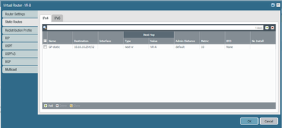

The system has two Virtual Routers for both ISP's. VR-A and VR-B. VR-A has the loopback interface added.
Virtual Router B has a static route to VR-A which has a route to the loopback interface with the Portal and Gateway.

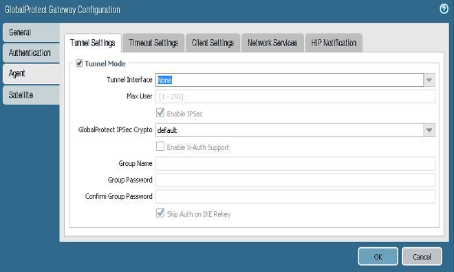

Great article @DonohoeRobert. Thank you for sharing this solution! Question: Even though the Portal and Gateway configurations point to the loopback interface and the loopback interface is assigned to the Global-Protect security zone, in Tunnel Settings in Agent in Gateway configuration, did you still have to configure a tunnel interface and choose it in here? Or did you leave 'Tunnel Mode' unchecked?Tunnel_Mode.JPG
Hi Mate,
No worries at all..
Ye need to create a tunnel interface here 100%. Gateway and portal on loopback interface is grand, but would enable tunnel mode as per normal as well.
Let us know how it goes, article a little old but can mock up in the lab again if needed.
