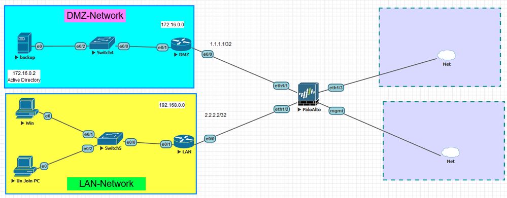

Dear Friends !
i am running RIP in entire Network with Dual ISP
the problem is that when 1 network part want to communicates with other part PBR just forward thier packets to Internet
how can i solved this issue to prefere routing table first and forward the packet to internet then

i am using above diagram and running RIP everywhere (DMZ, LAN and PAN)
i have dual ISP, when LAN Network want to communicates with DMZ, PAN just forward all packets to Primary ISP according to PBR role
in this case DMZ and LAN Network will not be able to communicates with each other
Kindly share your experiences !

i am running RIP with both internal routers as well in PAN
since PAN has PBR for Dual ISP and policy have internet route it PBR, everything is forwarding to Internet
when client in LAN network wans to communicates with DMZ network PAN just send the request to ISP
when i disable PBR and using only 1 ISP everying is working fine, but how to have Dual ISP failover when Using RIP everywhere ?
