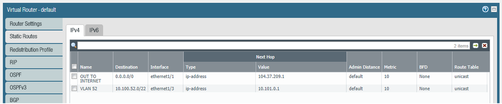

The U-Turn works for my internal network, the problem with the wireless network is it is independant, it only shares the internet interface Eth1/1 and the virtual router with the rest of the network, NAT & Policy & DHCP & DNS Proxy take it straight out to the internet and has filtering and security applied to the Security Policy. It seems to me I need a way to differentiate destination of internet traffic and send the desination 10.66.6.1/16 to that Eth1/8 interface were the 10.66.6.1/16 network resides
@SNikolaidis,
You could utilize PBF for that pretty easily but you shouldn't really have to. I feel like if you shared a network diagram along with your NAT policies and routing table we could likely get this straightened out without resorting to PBF.

But on the firewall is where DHCP, DNS Proxy (8.8.8.8) exist for the gateway 10.66.6.1 . The vlan 666 is completely cut off from anything other than the internet that which 10.66.6.1 gets through Security & NAT Policy to the ETH1/1 x.x.x.70/24 .
We want to keep this wireless network completely isolated from everything other than the internet. That being said, type our domain name into chrome and it just times out. Internally and Publicly everything loads just fine.
@SNikolaidis,
With how you describe it I would expect to actually see the traffic hitting the firewall as it comes back from your cable modem or at least see it trying to hit the untrust zone on your firewall. Have you enabled logging on the default interzone rule and checked the logs to see if you aren't simply blocking the traffic from reaching the server? If you can hit it with intrazone perfectly in your testig I would expect that you simply need to create a security policy to allow the zone tied to vlan 666 to access that web server.
@BPry
Have it working, had to set up another interface to an outside address on eth1/7 and set up a new virtual router that has my wireless network eth1/8 and 1/7 in it with a static route to the internet. May not be the best solution or best practice, but it works.
@SNikolaidis,
Actually that may be the best solution for actually making sure that it won't have any chance to get into your production network.
