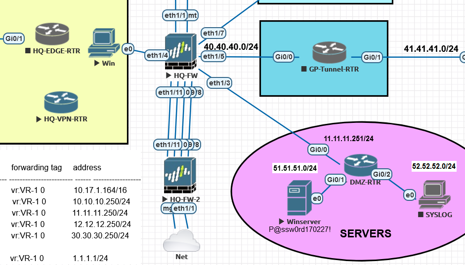

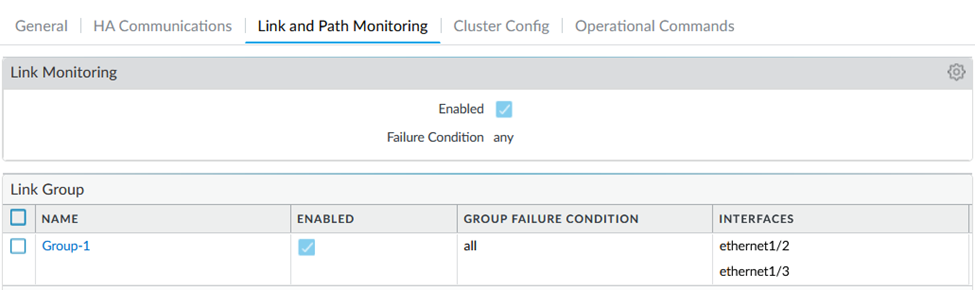

I am having some confusion on HA Link Monitoring and Failover. I did exactly the same thing with video courses and Palo alto document guide but it still doesn't work
For context, i am monitoring my eth1/2 and eth1/3 for failover. So i shut down the G0/0 interfaces of the routers directly connected to them and still there's no failover. I even configured the ethernet interface in Palo Alto to "down" state but no good. Am I missing something here?

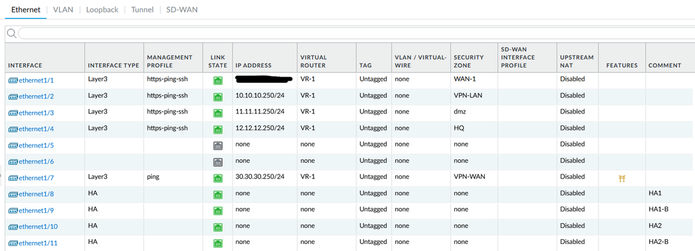

Does the status of eth1/2 and 1/3 change to linkdown after you shutdown G0/0?
In another words, GREEN should be changed to RED as below.

When I shut down the G0/0, my Palo Eth interfaces still shows green.

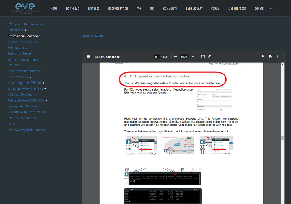

Ah, you are using PA-VM, I thought it is related to hardware appliance.
Even I'm not familiar with EVE-NG, seems EVE-PRO provides the feature related to link state.
If this doesn't work, maybe using path monitoring is easier than link monitoring.
https://www.eve-ng.net/index.php/documentation/professional-cookbook/

Hi @emr_1 , yep! This one is available on the pro i believe. But I resorted back to Path monitoring instead since I got a VM firewall. Much less of a headache 😄
