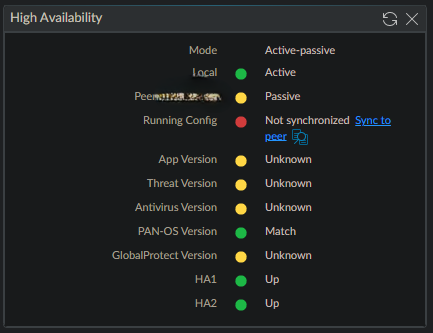

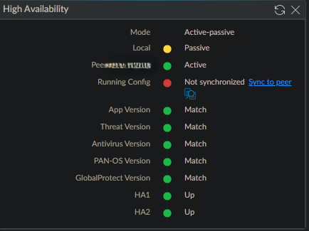

Need sync help. About two months ago we noticed our passive 3250 would slowly not respond. It finally died, no console response. Opened ticket, had one RMA, powered it up. Imported the saved config we took before it died. Checked ip's, management setting, etc and wired it up. Configs not in sync, expecting that. Sync to peer from active to passive via gui, fails. Sync via cli failes. Response we get back is "there was an error during the syncronation." That's it. Only one error in ha log on active. HA state on cli is normal for both. There is no PAN.
2024-04-23 16:09:34.483 -0500 Error: ha_peer_hello_callback(src/ha_peer.c:5373): Group 1 (HA1-MAIN): Peer namespace on peer device missing too long, trying to restart
It is two 3250's running 11.0.2-h4. They have both been rebooted recently due to code upgrades. Upgraded passive, reboot. Upgrade active, reboot. The passive took over with no issues and the active took control when it came back online (we used preempt). We use management port as HA1 and eth1/10 as HA2. Eth1/10 has been configured as a HA interface. Management IP on management port. The two can ping and ssh to each other. We have a set of 850's setup the same way that working fine. Can not direct connect the HA ports because they are 50 miles from each other.
We have opened multiple tickets with TAC. It has been over a month with no progress. There were six techs who all advised me to copy active to passive, change mnmt settings, sync. Done it eight times, still failes. Tried it with sync gui, sync cli, management plane restart, and force commit. We've defaulted the RMA and tried again. These are production so no "true" HA setup.
This is interesting. Passive can get active versions, active can not get passive versions. Idk.

On both firewalls the App, Threat, AV versions are Unknown. The running configuration is synchronized, but I had to synchronize them manually.
But auto sync is still not working afterwards. If I just click on "Click to see local and peer running configuration diff", I get the following error message: "Failed to get content for 'base--peer-running'!" and I found the same error as C.Dunn241943 in mp-log ha_agent.log:
Error: ha_peer_hello_callback(src/ha_peer.c:5373): Group 1 (HA1-MAIN): peer namespace on peer device missing too long, trying to restart
