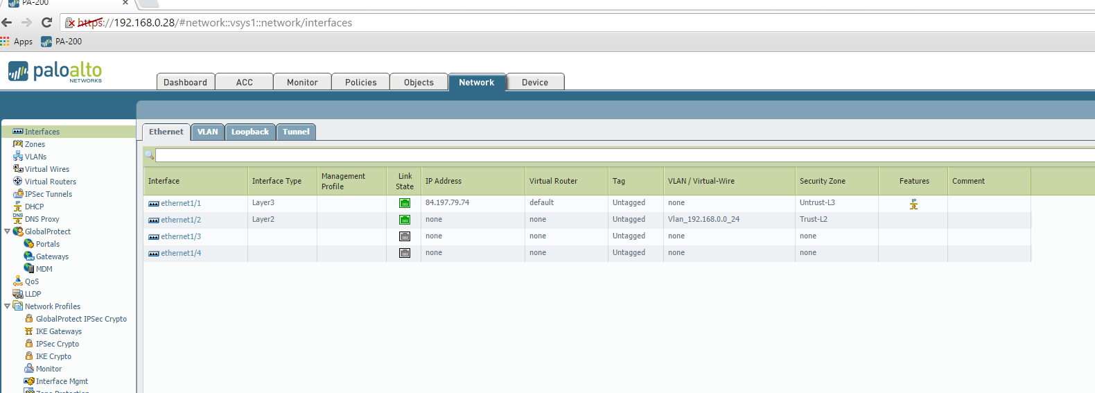

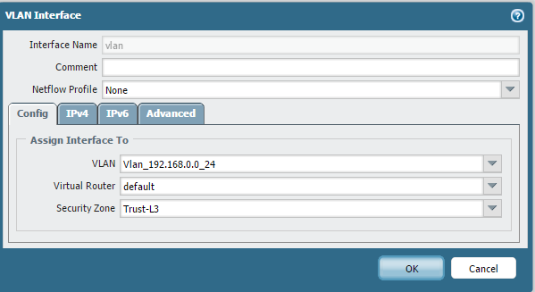

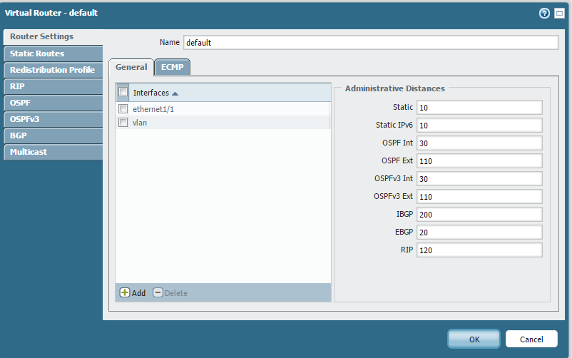

and here are some config pictures
interfaces
vlan

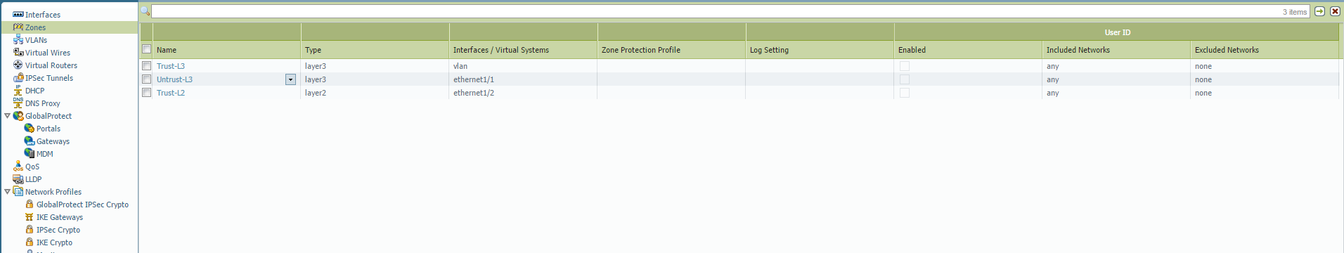

zones

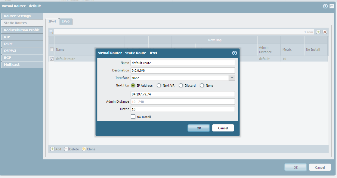

virtual router

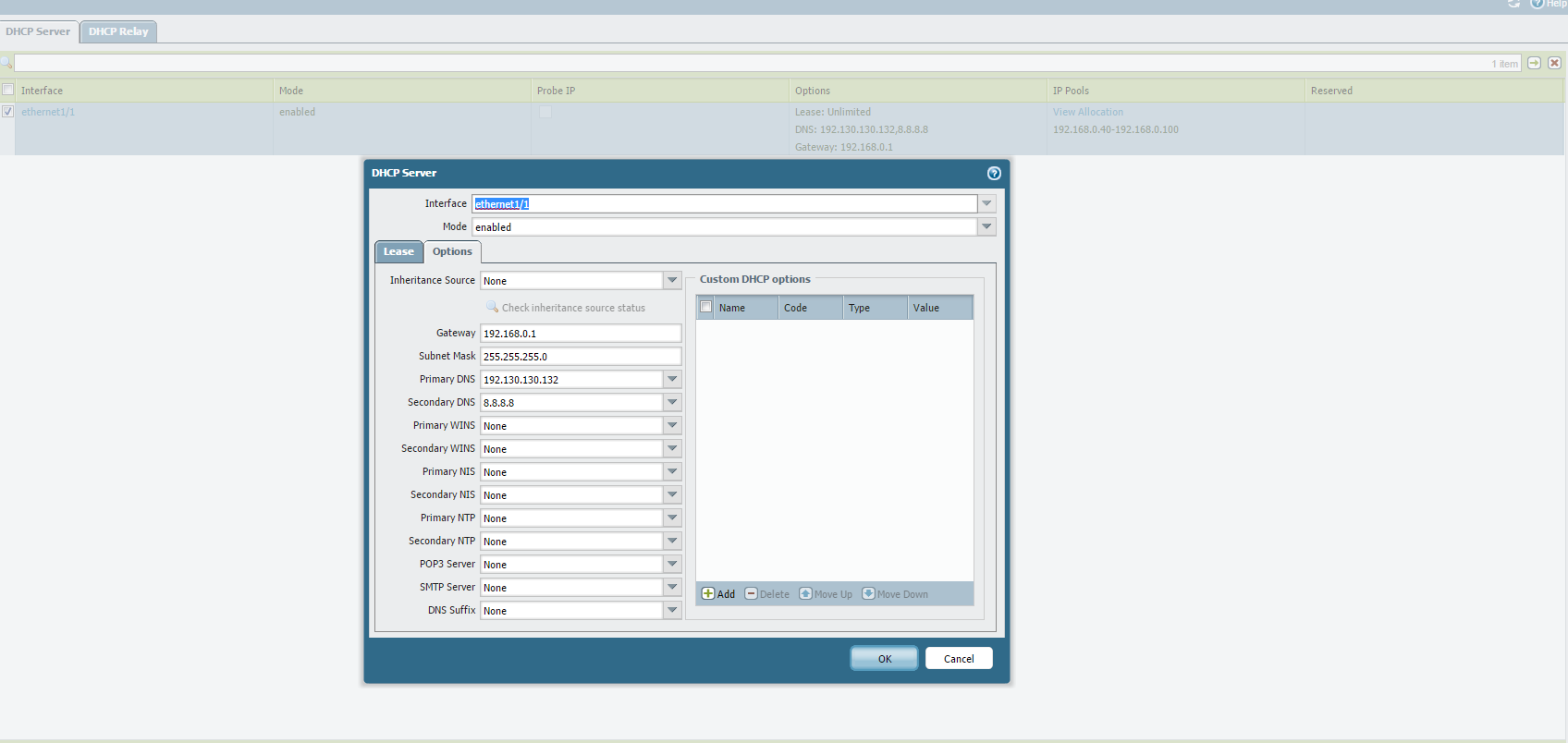

dhcp
Some suggestions / advice would be helpfull because im stuck.

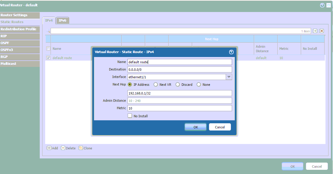

Looks like your default route is pointing at interface Ethernet1/1. It should be pointing to the next hop gateway. I also see that the same IP for Ethernet1/1 is he same one for your ISP router. It may help us help you if you can tell us how the two devices are connected and how they are to operate. ISP router -> PAN -> teust network or PAN ->ISP router -> trust network.

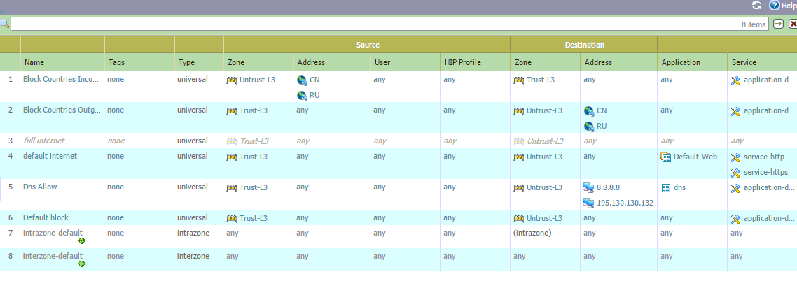

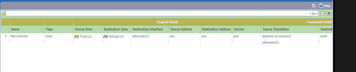

Also make sure your policies are allowing the traffic, trust ->untrust. (this is not pictured) also do you have a NAT for the internal traffic to the untrust network?

So i have changed ethernet 1/1 to an intern adress (192.168.0.130)
and vlan to 192.168.0.254/25
the next hop on the router is now 192.168.0.1

here are the pictures for the policies and nat rule

Add a default route in your VR making 0.0.0.0 point to 192.168.0.1
