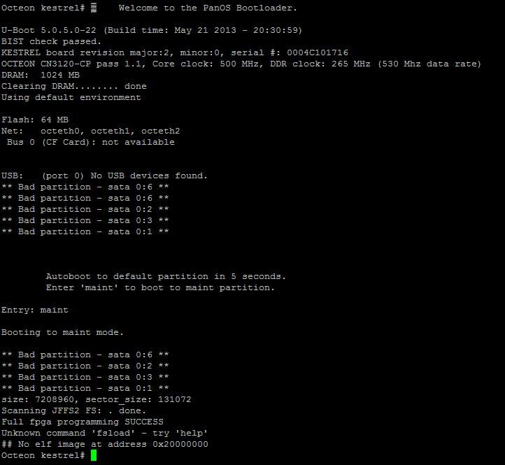

Hello Community,
I have my PA2020 with issues. The device is booting from PanOS Bootloader.
What is the proceess to upload and install again the PANOS?.
Best Regards
I think the reason you end up in bootloader is that the pan-os image can't be loaded because of disk issues.
I'd open a case asap.
I agree with santonic.
Looking at that log output I'm leaning towards a possible RMA.
Cheers !
-Kim
Same problem here. Most likely HDD issue :
