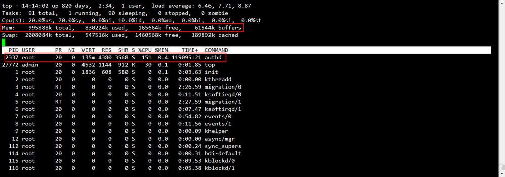

We used "show system resources follow" to check Memory, CPU usage and found that there is a daemon which called "authd" and its %CPU vales keeps around 180~200 range.
  1. Can any experts tell us about is it a normal behavior?
  2. Following is our PA-2020 Mem information, we only have less than 200M left, is it also a notmal status?
  3. If the "authd" daemon shound not use so many CPU resource, how can we restart this daemon?

@Spark1231,
Yes, you will be kicked from your SSH session until the management plane comes back online. 'request restart software' is the complete command.
authd is using way too much resources...
I'm not sure if you can restart authd on it's own... 4.1 is pretty ancient and to be honest I don't remember
can you give '> request restart software' a shot? (beware, this restarts the menagement plane, do not do this during production
your dataplabe will keep working but the system will lose it's "logic" for as long as the restart takes

@Spark1231,
I also had the issue in some 2050's I was running back in the day. There is a memory leak in that train of code that should be fixed in the newer ones. I would highly recommend upgrading to a newer release.
