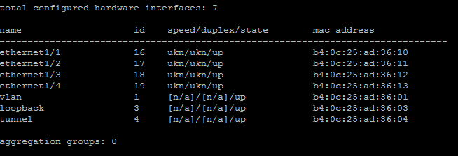

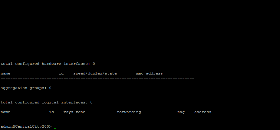

We started deploying Palo Alto in our environment about 6-7 months ago.  We're up at 19 PA200s in production (we also use Panorama).  Since we've been deploying these, I've had 6 units fail at 4 different sites.  The failure is always the same, basically the ports 1-4 are dead.  On some reboots they show as unknown/unknown/up when nothing is plugged in, and other reboots the firewall just flat out doesn't see the ports as available.

We've had a couple cases relating to the issue in the last couple of weeks, and it's to do with devices with certain serial numbers.
Looks like a hardware bug, rather than the usual software.
Palo are aware of the issue, so it's no surprise they're just RMA'ing your devices no questions asked.
